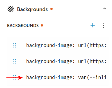

    when I set a background image to a container, GP adds automatically another background image:
    Why is that?
    The problem is, when I delete all backgrounds of that container (“Delete all background styles”), the inspector still shows me
    `<div class=”gb-element-02f8d783″ style=”–inline-bg-image: url(https://03 … .svg)”>
    How can I get rid of that?

    There’s a misunderstanding here: I’ve never touched ‘Inline Background Image’ on the Settings tab. I didn’t even know that I could add a background image on the Settings tab.
    If you look at my screenshot, it only concerns ‘Backgrounds’ on the Styles tab.
    My Problem is:
    1. I add Image1.svg to the list on the Styles tab.
    2. I add Image2.svg to the list on the Styles tab.
    3. GP adds var(--inline-bg-image) in third position on the list.
    I don’t understand step 3.
    Is that normal? What’s it for? What does var(--inline-bg-image) mean?

  • I’ve had another think about it… Could it be that I caused the problem myself?
    1. I added the background images via the Styles tab
    2. Later, I realised that I’d forgotten to disable the ‘Organise my uploads into month- and year-based folders’ option in WordPress
    3. I subsequently disabled the option ‘Organise my uploads into month- and year-based folders’
    4. For the sake of good order, I then moved the images using FileZilla from ‘wp-content/uploads/2026/03’ to ‘wp-content/uploads’
    This means that the links to the background images were leading to nowhere…
    Could that have caused the problem?
  • Ah, ok, possibly! Is it working smoothly now?
  • It seems so.
    If var(--inline-bg-image) crops up again, I’ll make a note straight away of what I’ve just done.
