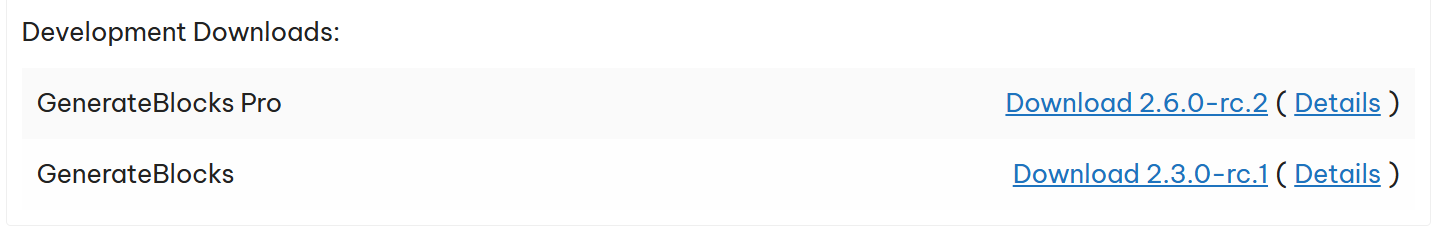

    Can you please update to the current RC versions currently available and try again? At the time of this post the latest RC versions are these:
    Current GB Pro and GB free RC versions
