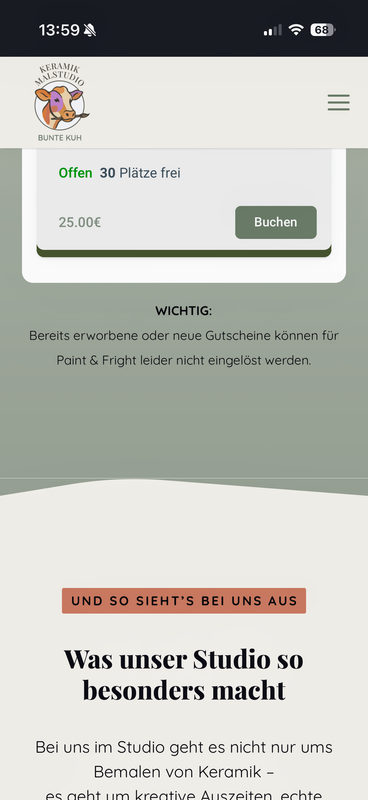

there is still a thin white line over a form. This is only on mobile. I already doublechecked this with margin and either with padding to set it -1px. Does not work.
Screenshot: https://i.postimg.cc/VkMnP2jv/IMG-5905.png

Hi Marco,
The thin line is coming from the shape divider’s background color.
Select the Shape block (.gb-shape-46e23945), switch to Mobile breakpoint then set Background Color to transparent or reduce its opacity to 0%.
Please leave the shape’s green Color unchanged. Set the background explicitly to transparent, as clearing the mobile value would inherit the desktop background.

The transparent color was set on the wrong Container. I’ve fixed that, so it should be okay now.

I changed the Shape’s SVG color to solid
#9fa69a, which matches the bottom of the section above. The SVG still had its own semi-transparent color overriding the color set on the Shape block.The Shape background is transparent, the previous container’s Z-index is cleared, and the -1px top margin is retained.
I’ve already applied and saved this on your site, then checked it at mobile and desktop widths. The thin line no longer appears in those checks.
