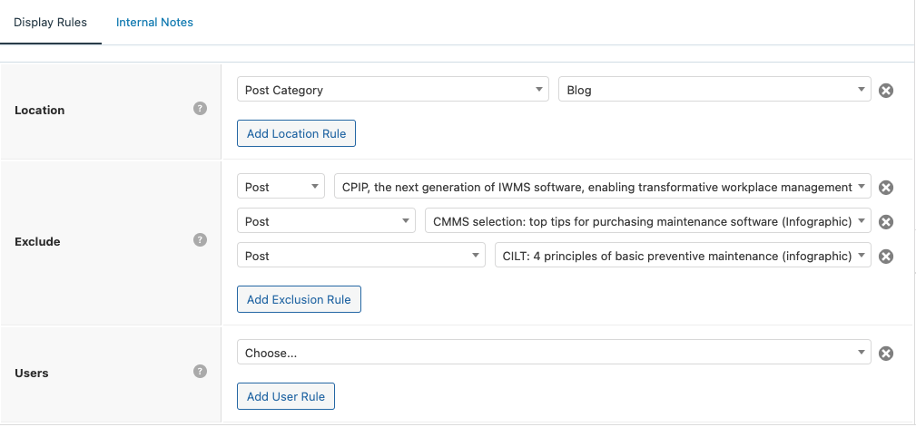

    I have made some elements in GeneratePress Elements and liked them to specific locations. For example, I made aan Element to show meta information on all posts within the category “Blog” which three exceptions. See screenshot.
    I was assuming that if we translated the posts and the GeneratePress element, let’s say in Dutch, th translated element would automatically show up on all Dutch versions of the elements in the Display Rule. But it doesn’t
    It seems we have to set display rules separatly for all the translations of the GeneratePress Element items.

    There isn’t really a problem with the translations of the posts or the Element. In this particular example it is just the exclusion rules which do seem to pass over correctly to the translated version of the Element.
    It is, however, possible to set them differently for every language, so having the Dutch version of the Element be excluded on selected Dutch items. It’s not the end of the world to set the Exclusion rules separately per language.
    When creating a translation of an element the rules are caried to the translated version also but they are just a copy of the original rules so connecting to the English posts. It would be nice if they would automatically transform to the correct language version of the item.

    Is it confirmed that to use specific posts or pages in the display rules they must be specific to each language ?
  • The exceptions only aparently. I mean, I have tested it only on our Blog section with an element with display rules to show on all posts within the “Blog” category, except some specified post. See the image I shared.
    The element will show on all post on all languages but the exceptions need to be set per language.
    That’s where I’m at. I haven’t tried it with other rules… yet πŸ˜‰
  • Yeah, its unavoidable as the display rules are post specific and each language version is its own post.
