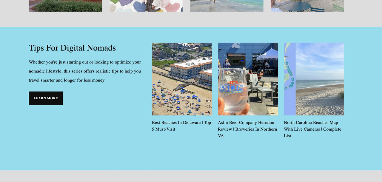

How do I update the blogs that are showing up in the section of my blog attached as a screenshot? I would like to show blogs in the digital nomad category but can’t figure out how to do that. My blog is inspiredbackpacker.com and that section is on the home page. Thanks!
Screenshot: https://i.postimg.cc/0NXm7Qf9/Screenshot-2026-08-05-at-11-23-12-AM.jpg

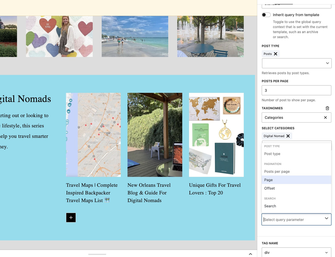

You can select the query block and click the Add Parameter button, select taxonomy > category, and select the category you want.
For more info: https://learn.generatepress.com/blocks/block/query/#add-parameter

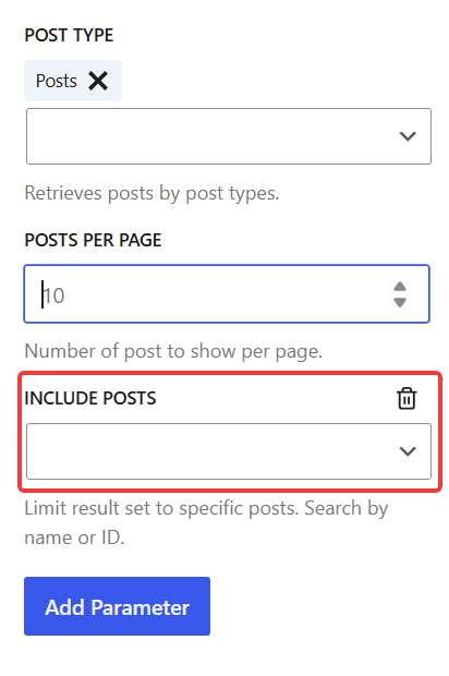

You would click the Add Parameter button and select Include posts as the parameter. Then you would include the posts you want from the INCLUDE POSTS drop down.

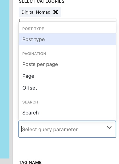

Gotcha- for some reason Post Type is blurred out as an option to select. Here’s a screenshot:
https://i.postimg.cc/CL6hSMbn/Screenshot-2026-08-30-at-10-41-20-AM.jpg
https://i.postimg.cc/mgvT1ddd/Screenshot-2026-08-30-at-10-41-27-AM.jpg -

Posts are already been selected as a source for the loop to make a query from. Go ahead and add the Include Posts parameter as I described earlier, then you will be able to select posts from the dropdown.
InspiredAssistance
Oh duh now I see it, thank you!!!
