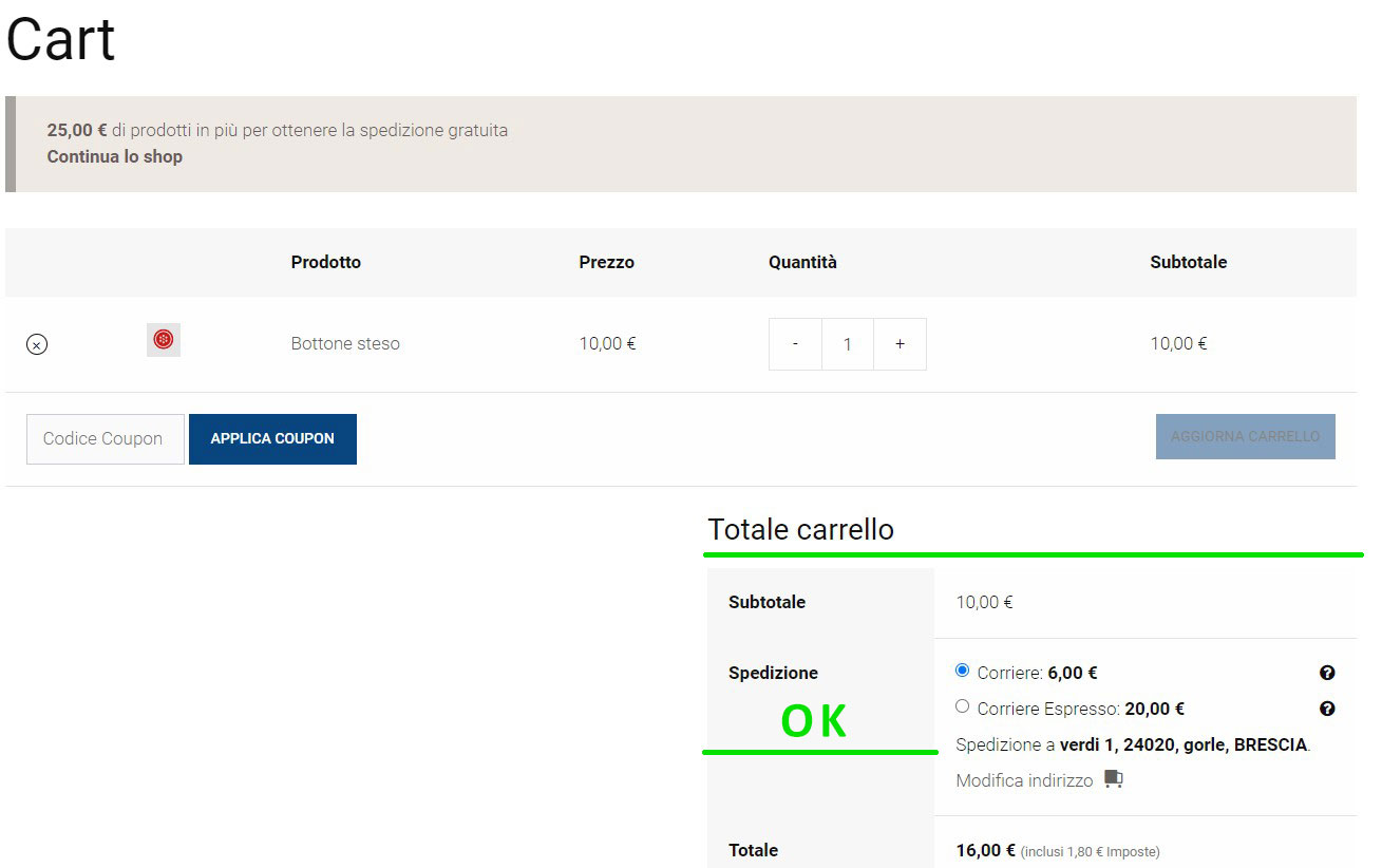

DeskTop CART: Title column width is fine and allows text to be displayed in full.

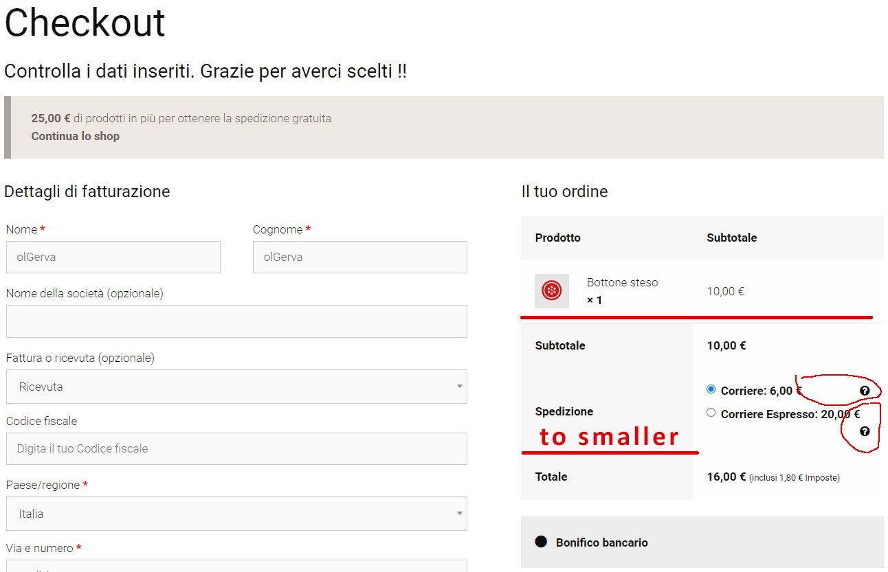

DeskTop CHECKOUT: in this case I would like the width of titles smaller so that there is more space for descriptive texts.

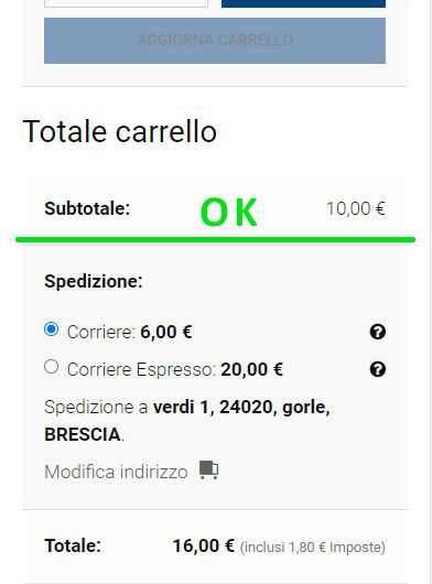

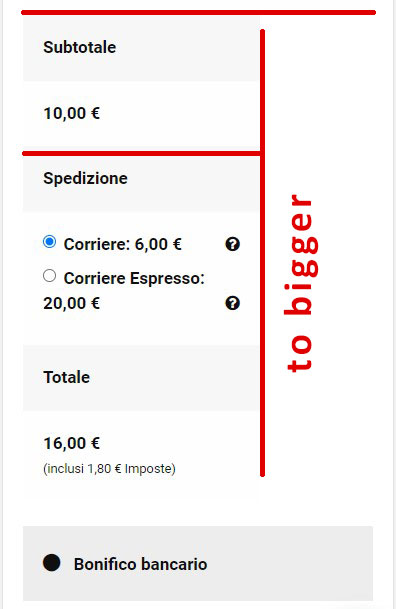

Mobile CART: I was able to paste title and sub texts at maximum width OK.
Mobile CHECKOUT: I end up with a smaller space and don’t understand how to enlarge it to the maximum available as in CART

DeskTop CHECKOUT I think I solved it -

For the mobile issue, try this CSS:
#billing_invoice_type_field span.select2.select2-container.select2-container--default { max-width: 100%; } -
GervaWeb
Thank you very much I went crazy …
